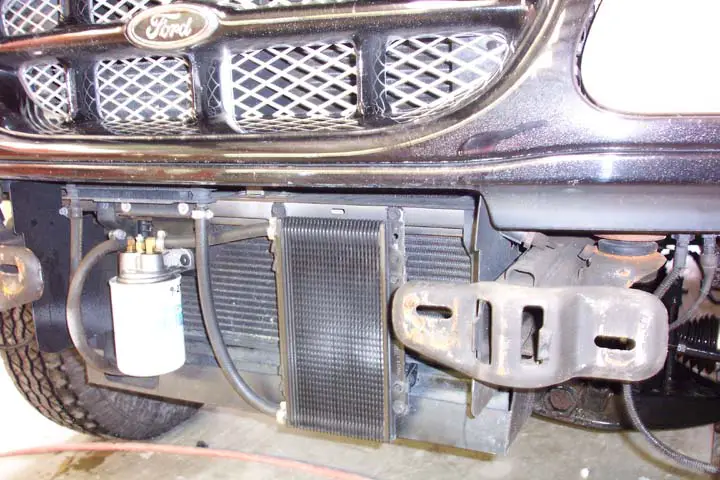

I got my B&M tranny cooler from Summit Racing.
At the same time I got a Perma-cool filter with a temp guage.
With basic mechanical knowledge you can instal both.
Here is mine. You can see the factory cooler to the top.

My cooler lines go into the radiator AND into a cooler in front of the radiator, does this mean I got 2 from the factory? Would it be overkill to have 3?

Yes, it appears that you have the factory cooler and no, it would not be overkill by any means; I have 3 on mine.
Yes you have the correct factory set up.
No, adding another won't hurt one single bit.
