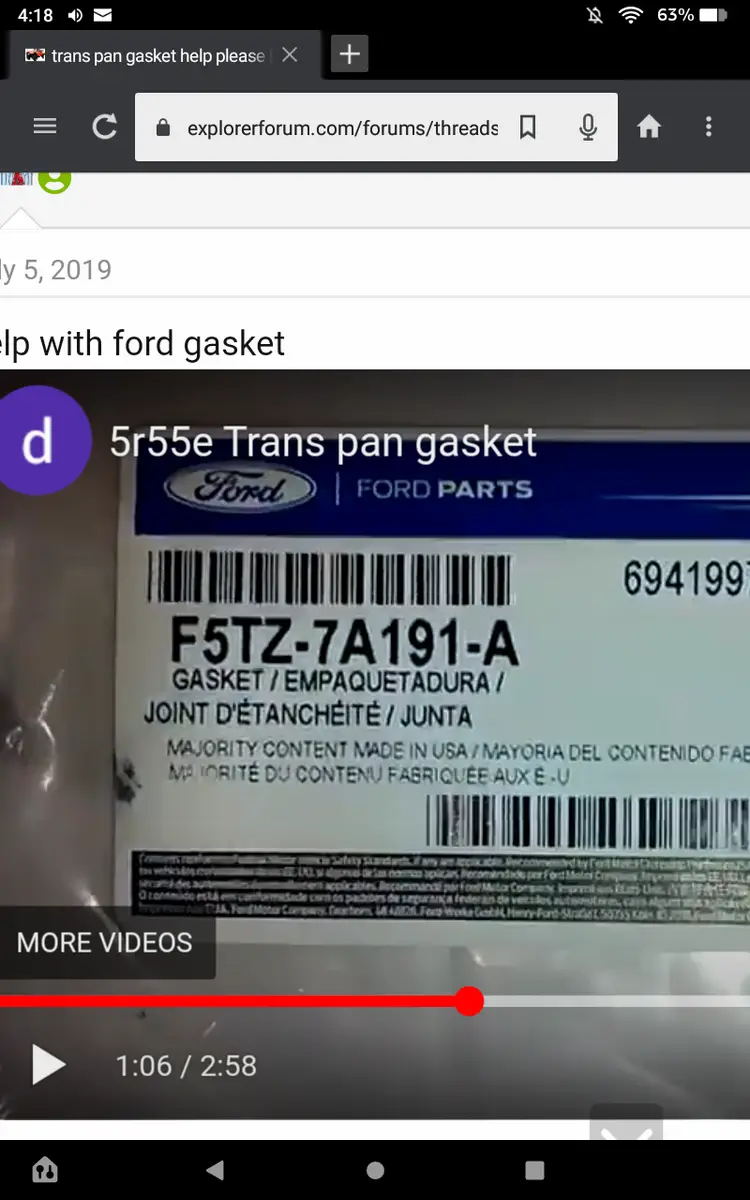

I like Kodas and Donald’s insight into these 5r55e pan gasket and filter - my transmission was rebuilt some 30k ago and I really have done best with motorcraft/Ford parts
What is the motorcraft/Ford pn for the 2wd pan gasket and filter ? I see Donald’s video - is that the right pn ?

Don- thx for the response - I studied the aluminum offering and i think it will interfere with the catalytic converter. - I think I’ll try the Ford gasket on the current pan - if I pull it off and see distortion I’ll get the doorman pan
Can you verify the Ford pn for the screen - F57Z 7A098A or is it motorcraft FT102 ?
Thx don - I’ll get that gasket - can I ask you what screen you used ?
