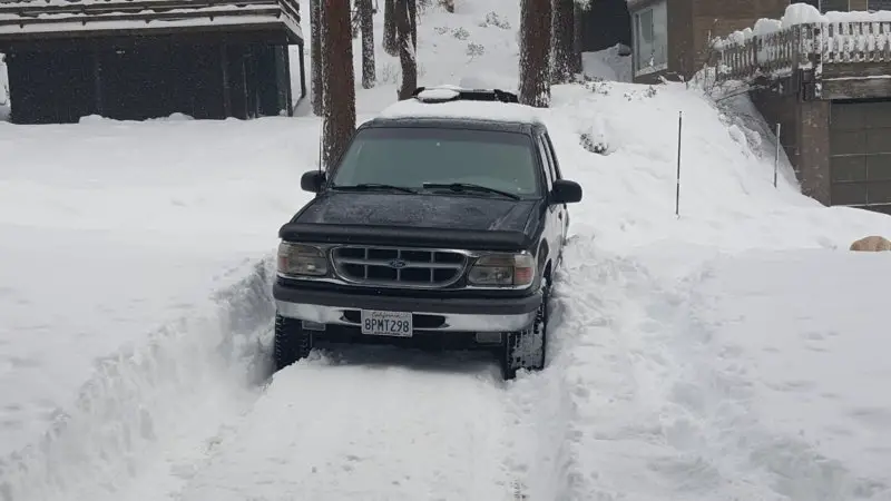

My transfer case made a noise when descending a steep hill in LOW-4x4. I kept it in 2nd gear and was letting it ride the gear to keep my speed down like truckers do. Well it popped out of gear and made a buzzing noise. I was able to shift to neutral and coast when I made it to the bottom of the hill I stopped. Switched to Auto and everything seemed fine. A few days later I backed the thing into about 2 feet of snow on my driveway. I was late for work and it got stuck. I was able to gas it and try and brake loose but the tires were all slipping. Eventually I unburied it. It drove fine the rest of the day. Around this time the lights to the AC/Heat controls went out. Few days later driving in 4 wheel drive on a ski hill. We were shuttling each other up and down the ski hill taking turns. This guy who is kind of an idiot was driving my Explorer and I noticed he was doing stupid things like accelerating into a hill and then hard braking. He said he kept hearing the noise and I wasn't sure what he was doing because I was skiing. I told him to just put it in Auto.
