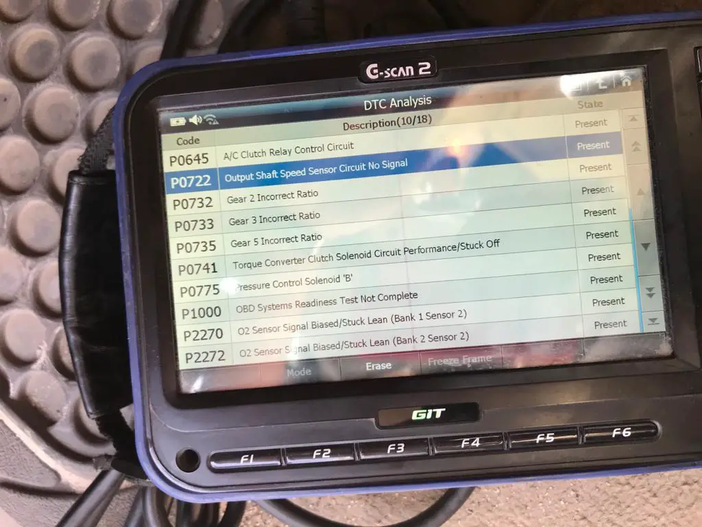

The thing is my 2008 v6 4.0 xlt had clunky shifting, I had to wait before it actually engages to Reverse for 5 seconds. After a while same happened when I put to on Drive.

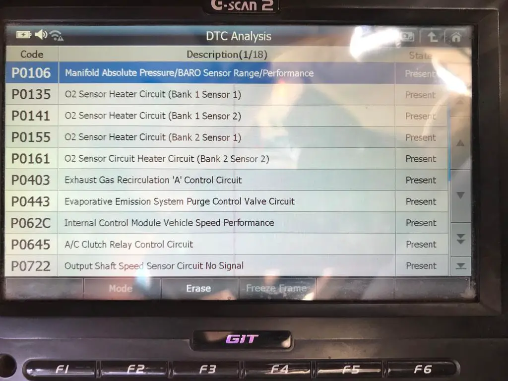

After a while it started to suffer on changing from 1 to 2 to 3 (that was the last number I could reach). Went to a guy who connected a computer and showed a bunch of errors that I will attach here. He told if I want to reset errors I said sure why not. 10 minutes driving and suddenly in the middle of street the D became like N, no matter what I do it's still like neutral.
Tried again one day later still the same. Is the resetting has anything to do with that? What do you think I can do to fix it?

Clearing the codes wont be the reason of the failure.
Make sure the fluid level is correct and if still no go chances are there is a internal failure.
You can remove the pan, if its full of debris then you will know for sure.

Thanks man gonna try and see
really appreciate your reply
