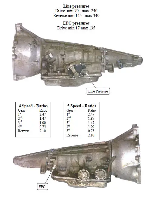

Ho everyone i have a 95 ford explorer 2 door. It has a 4r55e automtic transmission in it. I have changed bands valve body valve body gasket an changed the pig tail wiring going intothe transmission but i am having issues with it lossing drive an reverse. If i shut it off and then restart it all the gears come back. Im thinking its the pcm. Any help would be great.
This transmission should always have a drive gear and reverse regardless of what the computer does, even unplugged it should still pull forward in third gear (all solenoids off) and have reverse.
If you have a complete loss of forward and reverse and have to shut it off to get it to engage it makes me think of a clogged filter or some other problem with the main line pressure. Check line pressure with a gauge if you can.
trans issuses
Thanks gor the info iwill check line pressure. The trans has all new solenoids an filter. Along with the valve body an gaskets are new
