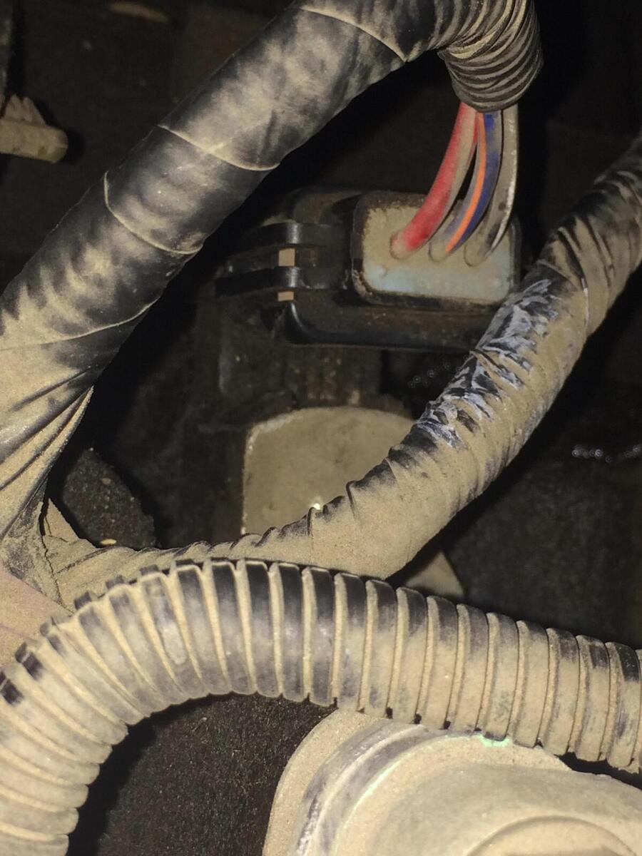

I couldnt't find anything wrong with the plugs and wires, no burn marks or exposed wire, all the harnesses look good. but when I checked my codes my OBD1 scanner only picked up 4 cylinders. so im not sure what that means. but here are some pictures of my coil pack and the cam sensor also unplugged the cam sensor and the truck ran perfect as usual. So im not sure whats going on, but It probably needs the plugs and wires and the coil done, so ill change those, and the IAC is supper gritty, tried to clean it but its still gritty. Oh and also cleaned the MAF.
I am pretty sure ( 98% sure) the cam sensor and crank sensor signals get "converged" . Intermittent faults in either could trigger this code.
I would replace the crank sensor for the cylinder ID fault. The problem could very well be in the camshaft position sensor however the crankshaft sensor has more reported issues associated with it, is less $ and easier to replace. It provides the cylinder ID for ignition.
I would replace the crank sensor for the cylinder ID fault. The problem could very well be in the camshaft position sensor however the crankshaft sensor has more reported issues associated with it, is less $ and easier to replace. It provides the cylinder ID for ignition.[/QU

Changing plugs and wires is easy. Changing the camshaft synchronizer is a lot of work.
i'd even be inclined to change the coil before messing with the cam synch.
I'm almost positive its the sensor now that i have gotten the bird like squeak, haven't changed the sensor yet been busy but ill update this once its installed.
