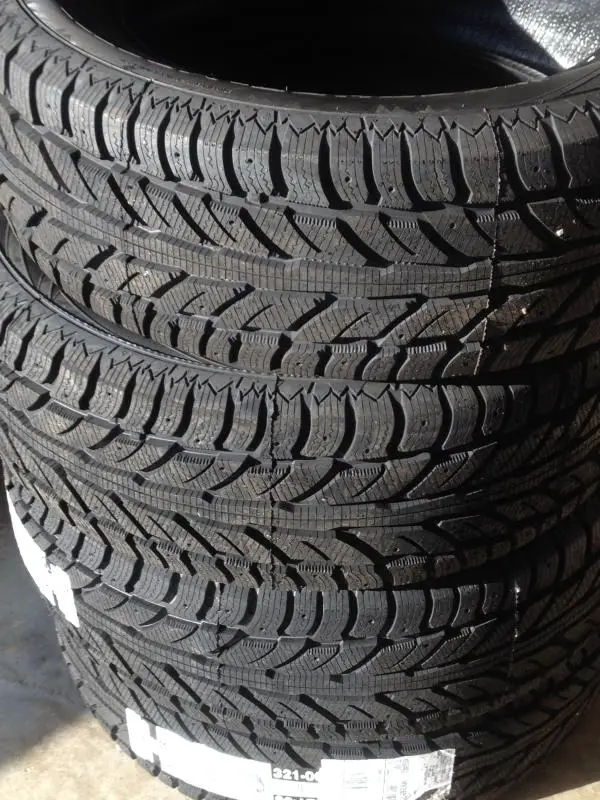

The thing that is going to help you most is a set of dedicated winter tires. The wimpy, all season tires that come on these vehicles should not be used for driving in snow and ice. Get some decent winter tires, and fear no snow!
Thank Halwg....with the new weather extremes, it does make sense. Whose brand are those? Are those yours?
Those are Cooper Weather-Master WSC. I am running them now and we have had some bad weather this weekend. They do great on ice and snow.
But as Peter says, there is an entire thread dedicated to winter tires, and everyone has their own preference for brands. I like these Coopers for the aggressive tread design. I also have to travel a lot of well roads and they do great in muddy conditions, as well.
