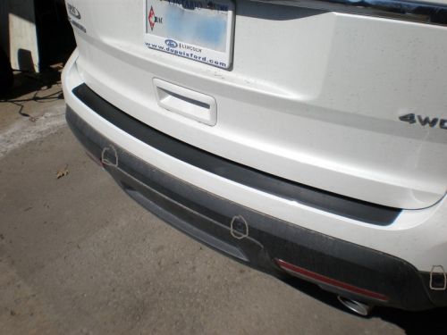

The ads online still refer to the Explorer as 4x4 and some even have 4x4 emblems on the rear hatch. Jeep does the same thing .
Have yet to see the 4X4 on the hatch. All those that come from the factory and I've seen including my previous one have a 4WD emblem. If you see one with a 4X4 emblem it was likely put on by the owner or they are a pre 2011 model.
Peter
still says 4WD not like the true AWD it is
