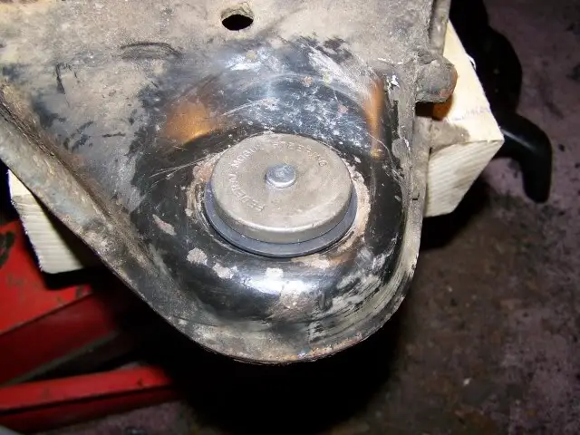

I am replacing my lower ball joint with a TRW 104222. No grease fitting was included in the box, and the ball joint has a cap pushed in where the grease fitting should go. I tried to pry it out, and thread in a grease fitting I had inmy tool box, but it wasn't moving without some real force.

Im now thinking that if it was to have a zerk fitting, there would not be this little cap stuck it. I'm conerned that if I force it out, and there are no threads for a fitting, Im going to be SOL...
I'd assume if there's a plug in the top it's for the fitting.
Not necessarily. My Tie rod ends have no grease fitting, but they do have the same type of cap where the fitting should be. They are Ford OEM

Here is a picture of the TRW joint installed, I am assume that there is not supposed to be a grease fitting on this joint since there is a small steel plug installed... I can only pray it lasts longer than the last one...

That's definitely a pressed in steel plug not intended for removal.
