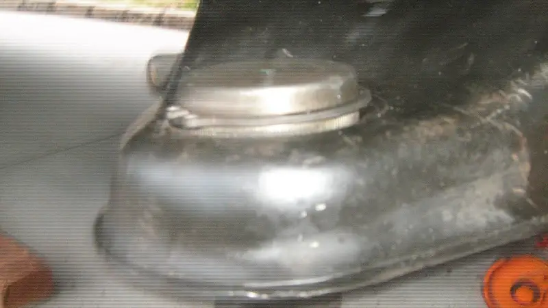

I just worked on the passengers side today. I purchased Moog as everyone suggested, but when I installed the LBJ, I was not sure if it looked right. The retainer clip is seated higher than the stock ones.
Is this right? I thought the retainer clip is suppose to sit flush with the control arm? If anyone can provide input, I would appreciate it.

Should be fine. Mine looked like this and it works perfectly for last 20,000 miles

I think having the retainer ring positioned higher than the arm is OK. I believe the retainer ring is only there to make sure the ball joint does not fall out in the event the press fit fails.
If the press fit fails and the joint works loose, the worst that will happen as long as the ring holds is that the ball joint will thrash around in the bore and your handling will go to hell. By then you should be aware that you need a new LCA as well as a new ball joint
