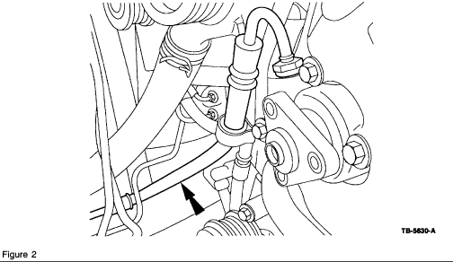

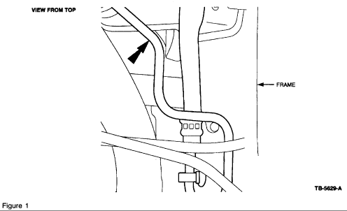

3.Install a new pressure Power Steering Hose (F87Z-3A719-JA). Isolate the metal lines on the steering assembly (use rubber hose). Refer to Figures 1 and 2

Figure 1

Figure 2
