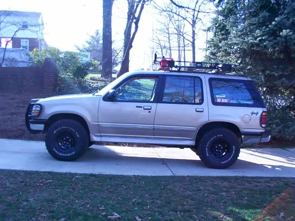

Is anybody running 32x11.5's with only a torsion twist and shackles/AAL. Im considering getting the tires just want to see some pics if anybody has that setup. Thanks john

Would 32x11.50's fit on a first gen with a 2 inch lift? I am guessing with a little fender trimming they would be okay. Has anybody done this?
Here's mine:
Dead Link Removed
Had a little rubbing though.. :rolleyes:
That is what I am running right now. (I have a little more wheel well on a Sport Trac) Mine only rubs at full turn on the inside of the front sway bar.

Section, are those stock wheels? They don't look stock, but one never knows.
Nope. American Racing Baja 15x8 (5x4.5) :D
That's what I thought. Thanks.
