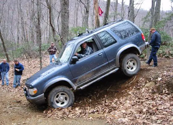

I've actually had/have both setups that you're considering.
Here's another shot of the roof lights (Webshots won't let me link)

For mounting the lights near the license plate, I just drilled holes in the sides of the brushguard. The bolts actually ran horizontal instead of vertical.
And the lights on my roof I made some brackets that mount to the factory roof rack ~ plenty strong, i have the same bracket in the rear holding up my CB antenna and it takes alot of abuse since its on top of the truck
yeah i wanna mount my other set like the black X u have...on the brushgaurd by the license plate

Same truck ~ all you need to do is drill a 3/8" hole and then buy longer mounting bolts and some spacers so the lights are centered between the guard and the license plate. Probably took me 2 hours including drive time to the hardware store on a saturday.
