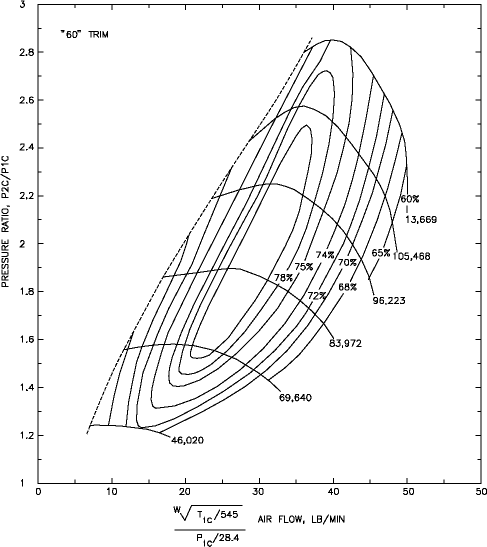

When looking at compressor adiabatic efficiencies one must take into account the displacement of the engine it is on, in addition to a few other things. While your T04 may have been maxxed at 19 psi on your smaller displacement engine, it will maxx at a lower psi on a larger displacement engine, while moving the same total amount of air, but at a lower boost pressure. Boost pressure is only a small portion of understanding the entire picture here. This is why it is a good idea to have someone plot a turbo compressor map for your application, if it's to be a custom one, so that you can determine if said turbo is a good option to take you where you want to go. Also, there are many different trims of T04 turbos that will exhibit very different adiabatic properties at similar pressure ratios and overall air volume flows.
Attached below are two examples that should help illustrate my point a bit better. Both "T04E" turbos, but with different compressor trims.

Its great to have a map to know what your limiting factors are. Most aftermarket manufacturers come with one. My old shop had some problems a few months back with a r otory engine and a turbo a guy installed. Guys think they can slap an hx35 from a 6bt cummins and have enough backpressure to run it efficiently.
