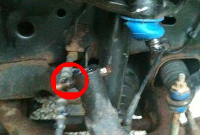

I did go over a nice size bump and pothole on our fine city streets right before this happend and I noticed the UCA doesn't move very freely, is The a way I can grease the bushings to free them up some? Ok, I just went outside in that lovely 100+ degree weather, took some better pictures and tried to move the UCA and I had to fight it to moved it up/ down a half inch, is it poosible when they did my alignment they over tightened the UCA bolts not allowing it to move freely with the rest of the suspension causing the upper balljoint to come out???

The upper control arm is often a little stiff when you move them by hand because it has rubber bushings at the the frame side which are squeezed and therefore binds a bit once the bolts are tightened (which is normal).
Can you remove that bolt? Cauz as I recall, it should have a "lobe" on one side.
Iz, the upper ball joint has a dimple ridge which the bolt shaft locks to--
I don't think the upper ball joint was fully seated and assembled --I feel it was not in far enough for the bolt to catch it. Looking at the bolt, it's diameter penetrates into the spindle area far enough--but I fee it was actually riding below the ridge in the ball joint spindle shaft.
Edit, the reason I say this is because I have seen it done in my driveway whilst helping another member. He did the joint himself, while it almost looked good, the boot was not smashed enough and I noticed it. The pinch bolt was in, but it was below the ball joint shaft.
Then I'm probably mistaken - I could've sworn that bolt has a lobe on it and can only be inserted into the knuckle one way. But I probably have this mixed up with something else.
I think it's the picnh bolt because it doesn't look wide enough to hold the balljoint shaft in there, looks like a knotch was taken out of the bolt when the balljoint popped out. I seriously can't wait to do my SAS, SOA, I can't stand IFS. Im used to working on straight axles from my old Scout II and Waggy. Damn.

I just took the pinch bolt and UCA off. The pinch bolt has a knotch out of it where the shaft of the balljoint sheared right through it.
What was the measurement of the ball joint end? The diameter of that will tell if it was undersized or not.
If it was undersized, and with all that grease you had packed in there, add a sever jarring from a pothole, and you have a recipe for disaster.
I still need to measure the diameter of the balljoint shaft. I didn't have any grease on or in the spindle, all of that was crushed out of the balljoint when it came apart and got crushed between the knuckle and tire. I probabaly did put too much grease in the balljoint.
There's a nice little knotch taken out of the pinch bolt where the balljoint shaft sheared right through it.
I just checked and the new part should be here today sometime, I think I might go to the hardware store and get some Grade 8 bolts and nuts to replcae the weak ones that came with the UCA/ balljoint.
That's just the thing - plenty of us have replaced the upper arm / ball joint using the hardware that came with the truck or the kit and the ball joint didn't pull out of the knuckle. So I'm thinking that the bolt is probably not the culprit cauz there shouldnt be that much axial (vertical) force on the ball joint (most of it is radial) to the point where its able to eat through the retaining bolt.
I installed the bolts that came with the UCA, when I tightened them down they spun the threads right off (air rachet) when it got too tight (the metel of the new bolts was too soft caused the threads to spin right off). I had to re-use the old pinch bolts, the bolts looked good and were alittle worn down where it goes in and holds the shaft in at the shank but just not thick enough to hold it in there. There's a knotch taken out of the pinch bolt where the shank sheared right through it.
Now I know not to use the old bolts on the balljoints, My new UCA came today so I'm melting outside installing them as we type (taking a cool down break) for a minute. I'll just use a regular rachet when I tighten the bolt down this time so I down spin the threads off. This is the first time for me working on this type of balljoint setup (IFS), I'm used to straight axles and other designs.
After the air rachet stripped the threads I put the original stock pinch bolts. The bolt was alittle worn down but still thick enough to hold the balljoint in place, or so I thought.
