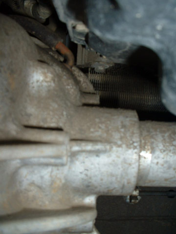

That piece is usually pressed in from the factory and will probably be a PITA to get back in. You may have to end up reaming the hole a little and epoxying the piece back in place. Here is a pix of the fitting. I took it from behind the axle facing forward.

Arugh! I dont have the slightest idea how to ream the hole, and would epoxy stick on grease? I almost JBwelded it, but decided that wouldn't be the best idea.
