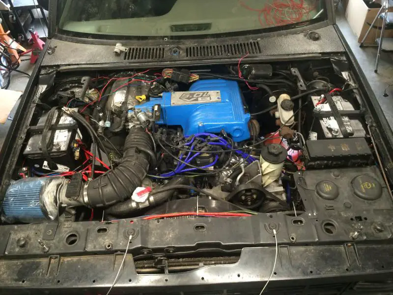

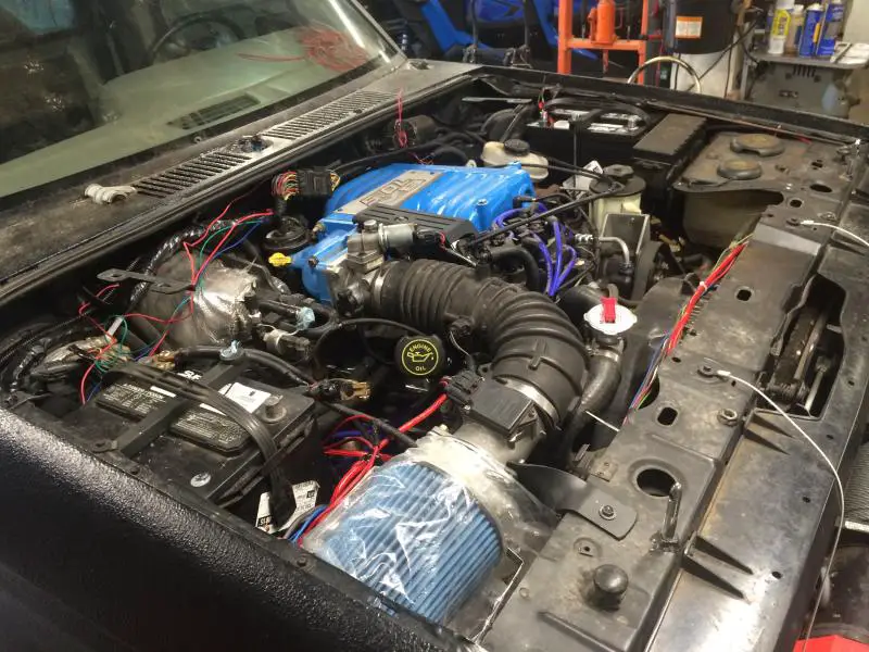

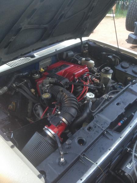

In my friends 84 Ranger "Darth Ranger" we built he has dual batteries, ac and cruise control all under the hood of an 84 with a 370hp ATK crank HP) crate engine
My 88 and Darth ranger both use a 4.0 all aluminum tig welded EBay radiator tucked under the radiator support, dual transmission coolers, and ac condenser all installed in the cooling stack. I use a 96 5.0 metal fan and 4.0 fan shroud
84 ranger "Darth" engine bay:
my BII, sans batteries
Both trucks running 1" intake spacer also. My BII has James Duff urethane body mounts that were shaved 3/8"
