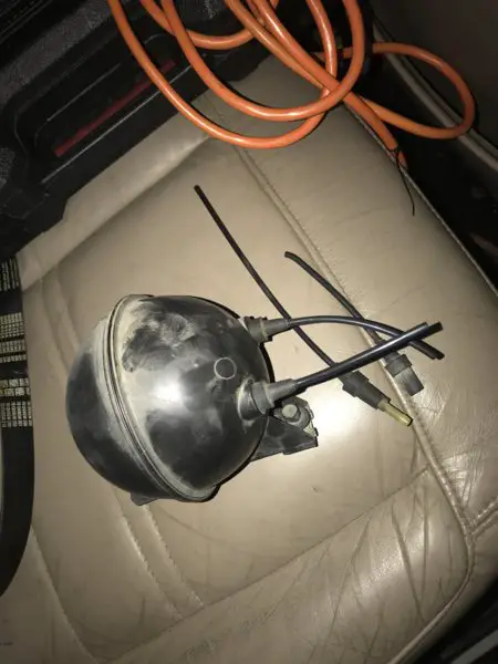

2000 Explorer SOHC. Was doing spark plugs and wires and snapped a vacuum line attached to a vacuum reservoir. It’s like a ball thing inside the fender liner under the airbox. Need to find the new hoses/lines.
Looks like this
That ball basically stores vacuum pressure so when you accelerate and manifold vacuum goes down the ac actuator will hold steady - we repair those line most often with just the right diameter hose splicing the breAk - don’t know why you would need to replace the ball
Unless it’s cracked - see if it will hold a vacum
The ball is fine. I need the new lines, the lines cracked

You don’t think they sell new ones anywhere, or even the full harness? Not sure if junk yard would help because the lines actually broke because they are very brittle. It’s like a spaghetti noodle lol
Do the lines pull out of the rubber boots? Don't try TOO hard and break them further, because if they don't then you could just get a piece of rubber hose with the right inner diameter to splice it, but if they do come out of the boots then you should be able to buy the same size vac line at an auto parts store, probably on a spool behind the counter so take the line there for a size comparison. For example:

Get small rubber vacuum line from auto parts store, use it to splice the broken bits
@J C is correct that is the simple repair and we have to do this alot as the plastic POS vacuum lines get brittle and snap
You can purchase new plastic line at the auto parts stores (be sure to get the right diameter if you do), but as said most people just splice broken lines back together with a short piece of rubber vacuum line of the appropriate diameter. My AutoZone keeps a box of short scrap pieces of left over vacuum line that they'll let you have for free. If possible take a piece of broken plastic line with you for getting the size needed.

I suggest as others have, splicing the break in the line with a piece of small inner diameter rubber hose
Hope that helps!
Thank you everyone. I’ll try the splicing method
