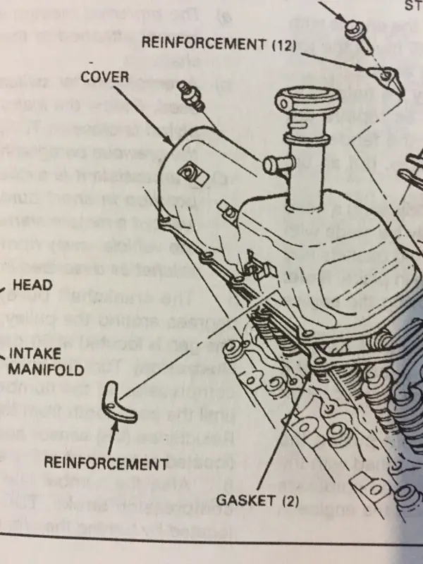

Did all these 4.0's come with these reinforcement plates? I don't have them, or can't find them. Looking at my old valve covers, it really appears they were never there.
Would it be best to pick some up from the wrecker before installing the valve covers?

My 1991 has them. My next "big job"...I need to put valve cover gaskets on but dread all the other stuff I'm liable to break in the process...
(lost photo)
As for necessity? I don't know.
newer ones used a metal/rubber hybrid valve cover gasket. Felpro makes gaskets for these that use a hard plastic frame that works great. I have used straight RTV in the past with success, but like many others, I have found it a huge PITA later. The only reason to use RTV is if you absolutely have to. If you know in advance, buy gaskets. Avoid cork.
Pretty sure both my 1991 and 1994 have them. I would get them if I didn't. If you absolutely cannot find them, I'd use a good layer of RTV and not torque the bolts too tight.

They do come stock, but I've lost a few. I've searched for a supplier for the those VC bolt tabs and Ive never found one.
