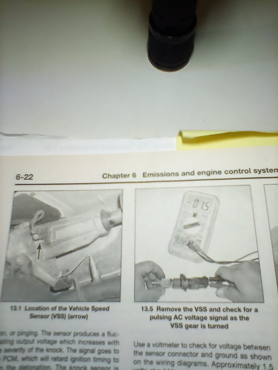

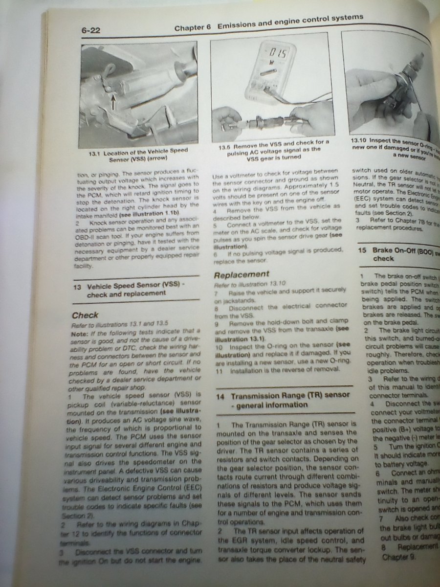

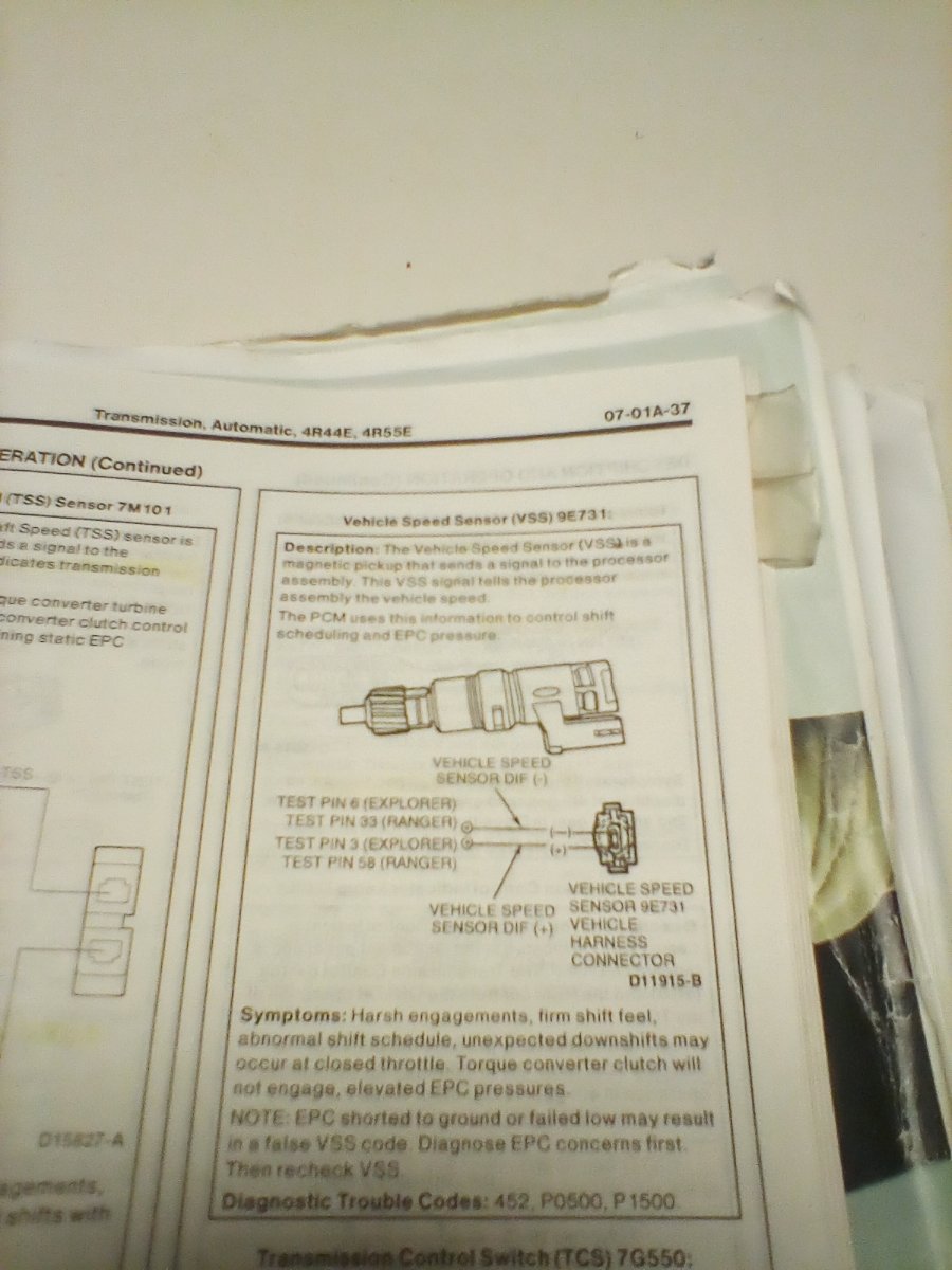

Does anyone know the test procedure for a vehicle speed sensor on a 97 Mountaineer 5.0. Mine is the VSS that's in the transfer case. My speedometer and odometer stopped working suddenly and then I got a VSS Code P0500. I changed the sensor but it didn't fix anything. I hooked the old sensor to a drill with my meter attached and when I spin the drill, the voltage increases. I plugged it into the vehicle and spun it with a drill with key on - engine off and the speedometer does not move. I looked in the sensor hole with a boroscope and the drive gear looked ok (at least from what I could tell) I'm not really sure what the problem is. Thanks
