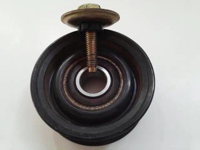

Today I pulled the serpentine belt off and found the lower right idler pulley had a lot of play and a rattle. Removed the pulley and found the bearing is smooth and tight and the vibration is significantly reduced without the belt on. While the center bolt is tight the rattle is because the pulley is not tightly held to the nub of a shaft on the accessory casting and the plastic insert on the bolt head.
Any suggestions?
While the idler pulley seemed good held in the hand it had some play when bolted in place so it got replaced. That didn't change the engine vibration.

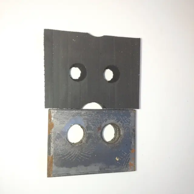

I visited with my local Hot Rod shop that installed the exhaust system today. While they could not find any exhaust problems they suggested the only solution in their area of concern is to isolate the engine from the large/long exhaust system with a flex coupling such as this:
http://www.ebay.com/itm/2-1-4-ID-Ex...8551b94&pid=100033&rk=3&rkt=4&sd=271133100345
We are going to try that and see what is accomplished.

I got the exhaust isolators installed.
. . . and installed some industrial vibration damping material between the custom engine swap motor mount brackets and where they are bolted to the frame of the Volvo.

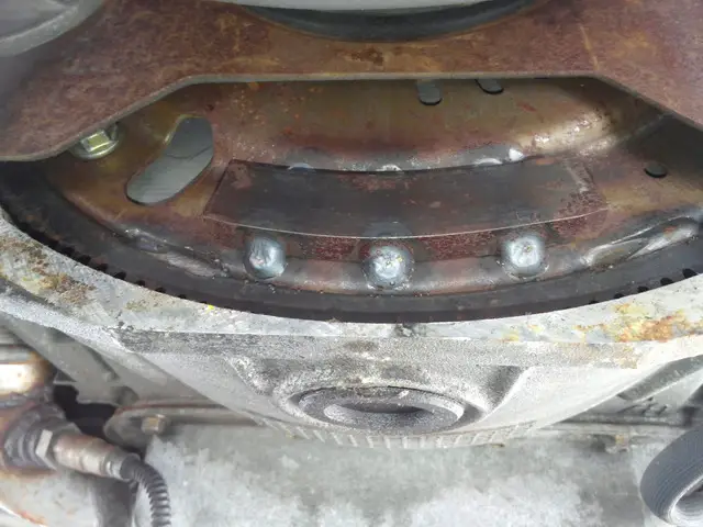

Pulled the flex plate inspection plate and verified that the torque converter nuts were tight. That is one honking big balance weight on the flex plate.
No change in the vibration. It is definitely engine related or at most HB through TC.

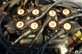

Here is the cylinder/spark plug wire arrangement that is not documented anywhere that I could find. Even got the local Ford store technicians in a discussion and they could not find any documentation on the physical connections on the coils. Said that they just replace wires as they find them. You might want to keep this picture as it is the only place on the planet where this information exists.

I got the big green Ford books out to check on spark plug wiring routing for the crossfire question. There it is in great detail on page 303-07C-6. Then I wondered why the coil connections are not provided. It was good on the left side, required swapping the 1/3 wires in the loom at the coil.
Thinking with my fingers one might surmise, in a wasted spark system, that pairs of cylinders on a common crank journal reaching TDC at the same time would fire at the same time one on the compression stroke, one on the exhaust stroke. Ergo cylinders 1 and 5 reach TDC at the same time and both should fire at the same time. Same with 4 and 8. That makes sense if you assume that the coils fire front/back in pairs. I'm not sure how to confirm that.
What doesn't make sense is that cylinder pairs 2/6 and 3/7 are not wired that way on my coils.
Before I go switching plug wires around could someone with the same wasted spark system on a 5.0L please verify the wire configuration . . . pretty please?
Your firing order is good.
Had this issue on my son's 98 and found a slightly cracked spark plug ceramic. Replaced the plugs, which were new by the way, and this stumble, vibration was fixed.
Seemed to me like the vibration, miss was only at 2k RPMs when any force was applied to the gas pedal. After the vibration, stumble, it ran fine otherwise.It only stumbled right at 2 k rpms.
Thanks for the response and it is not that I don't believe you but I can't get my head around the fact that cylinders 1/5 are next to one another as is 4/8 but not 2/6 and 3/7. Why wouldn't the other crank journal mates use the same configuration? The internal schematic for the coils show coil pairs triggered together.
