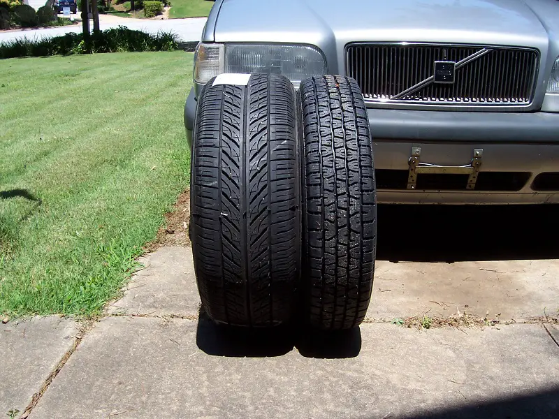

New spare & mpg
You could look for a 155-80-15 tire. BFG has a Radial T/A in that size, and recommended wheel width is 4½"-5½".
Tires around that size are popular with the old school VW cars and buses...
Thank you for your suggestion! I've been watching eBay for several months for the best price on the 155/80R15. I finally got a new one for $89 with free shipping. I got the tire installed on the spare 4 inch wide rim today for $12. The tire shop installer said replacing a donut spare with the small 155/80R15 was definitely thniking outside of the box. They would use the idea in the future with their customers. I'm embarrassed to say that I failed to give you credit.
The tire fit fine on the smaller width rim. It only has an S speed rating, a 1073 lb load rating and a 24.8 inch diameter compared to my Bridgestone Potenza RE-960 W speed rating, 1356 lb load rating and a 24.9 inch diameter. But the ratings are vastly superior to the original donut spare 45 mph and 50 mile ratings.
By the way, a 4th decent remaining tread 205/55R16 Potenza finally showed up on eBay so I bought it a few days ago. My Potenza RE-960 size has recently been discontinued by Bridgestone except for the run flat tires so that was a lucky break.

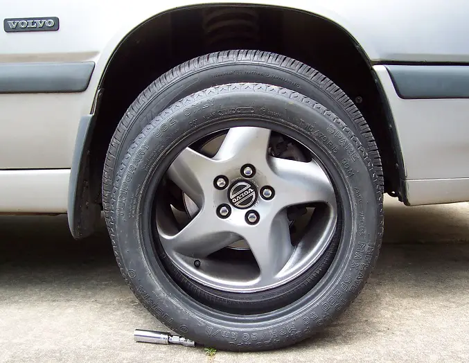

Disappointing lesson
Unfortunately, I've learned not to trust someone selling a used vehicle. I assumed that the wheel in the spare compartment was for my Volvo but when I attempted to use the spare to replace my fourth dry rotted tire I found out otherwise. The first clue was the lack of the locator pin hole. The next clue was the obvious difference in the bolt circle diameter of the spare rim vs the hub. To resolve the problem I purchased a used Volvo donut spare, paid to have the donut tire removed from the Volvo rim, and the new BFG tire removed from the unknown rim and installed on the Volvo rim as shown below.
Below is a comparison of the stock Volvo donut spare tire to a turbo wheel with Bridgestone 205/55R16 Potenza RE-960.
It has been an expensive process to end up with a decent spare.
Damn, what a nightmare. Good that you figured it out now, and not on the side of the road somewhere.
