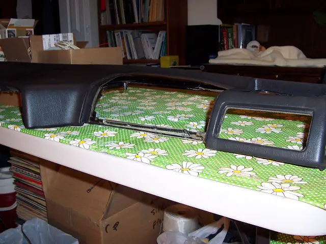

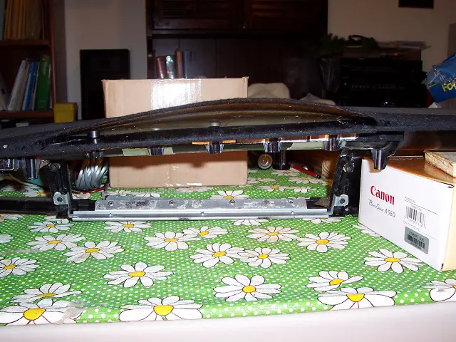

I was able to remove the passenger air bag without deploying it. I separated the air bag cover from the dash. The photos below show the unsightly bulges in the main section of the upper dash.

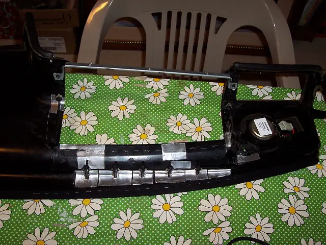

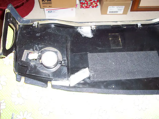

When I examined the underside of the dash I found numerous splits in the plastic. I glued the splits back together with superglue and then reinforced them with aluminum flashing stock as shown below.
This was a tedious and time consuming process.

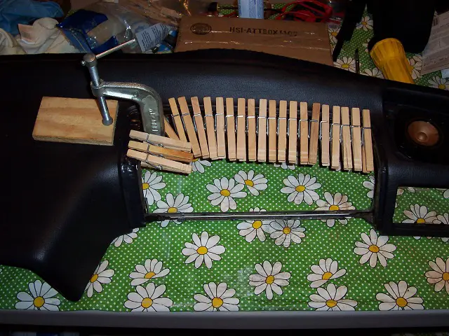

Repairing the dash bulges

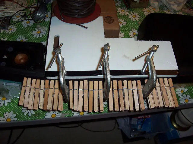

Next I used two part epoxy to glue the leather bulges to the plastic form as shown below.

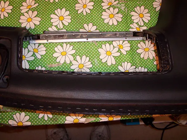

Even though I waited 24 hours before removing the clamps the glue did not hold to the rubber like substance that is bonded to the underside of the leather. Instead of trying a different glue and chancing it coming loose I decided to "sew" the leather to the plastic. I used 24 gauge galvanized steel solid wire as my "thread". I used my electric drill and a 3/64 inch drill to make a hole for every "stitch". The results are shown below.
The stitches will not be visible when the dash and the airbag cover are installed. I doubt the leather will ever separate from the plastic again. I still have to repair the broken plastic airbag cover and reattach the leather to it.

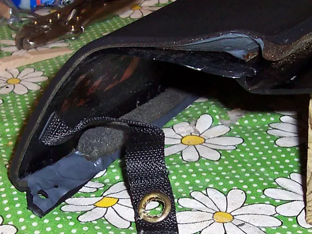

The two photos below show how the shrinking leather pulled away from the airbag cover plastic frame.

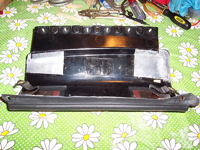

A large section of the plastic was broken completely off on one end and there were cracks on the other end. It was necessary to reinforce the plastic with metal flashing as shown below.

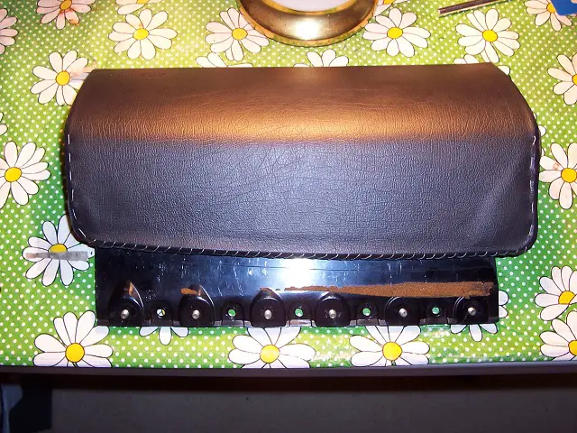

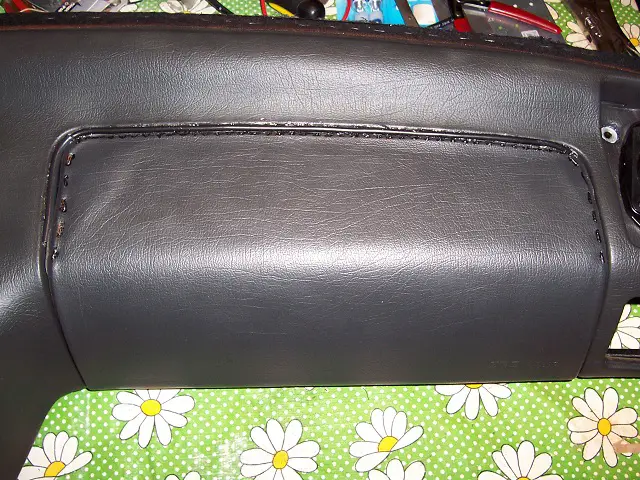

Even though I tried an adhesive advertised to work on leather and plastic and let it dry for 48 hours the leather began separating from the plastic within two hours after removing the clamps. So I reverted to sewing the leather to the plastic with metal thread as shown below.
Because the leather had shrunk when I reinstalled the airbag cover into the upper section of the dash there was a gap on the left side as shown below.
Also, the stitches at the top were more visable than I had planned.
So I used two different gauges of wire with black insulation to fill the gaps.
I attached the wire with adhesive only applied to the dash and not the airbag cover so it would not interfere with the airbag deployment. It's not perfect but I've spent way more time than I planned on this particular task so it will have to be good enough.
