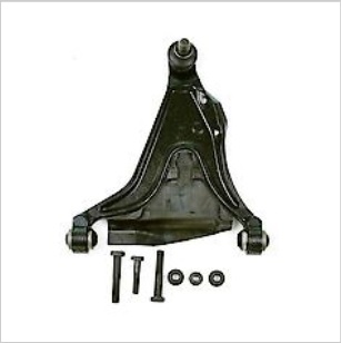

Bad lower ball joint
While checking the brake pad thickness I noticed that the left lower ball joint is badly worn. It moves more than 1/8 inch within the seat. Unfortunately, the ball joint is not replaceable and I had to order an entire control arm assembly.
My asking price for the vehicle just increased by $200 to offset the cost of the part and an alignment. Hopefully, I won't notice any more defective parts.
