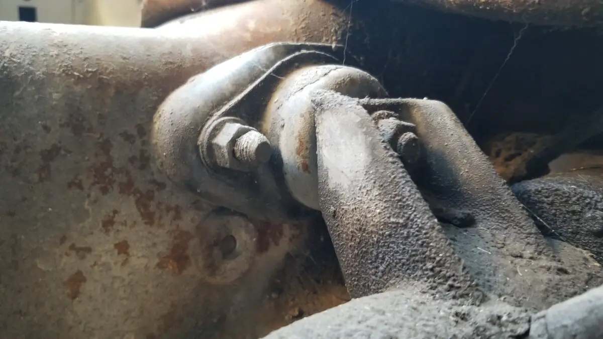

Are you sure the bushings are bad? There is a bracket on the driver's side of the differential that cracks between the 2 mounting bolts. If the bushings are bad, you will have to use polyurethane to make new bushings, energy suspension sells a kit. I use window weld cause it is cheaper. My van has a cracked mounting bracket, I'll attach some photos of the bushings for reference.
