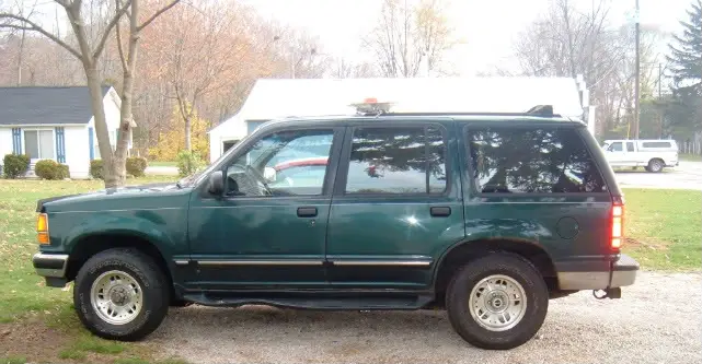

This is a pic of my X
Well the SOA will give you a good 5.5" of lift so you dont want to do that. And when lifting the front more than 2in you will need axle drop brackets to correct the alignment. So your best two options are to either get a 3in body lift and f150 coil seats for the front and extended shackles for the rear(which will give you around 4.5" total and is the cheapest method) or just buy a complete 4in lift kit from superlift, rough country, skyjacker, etc...
