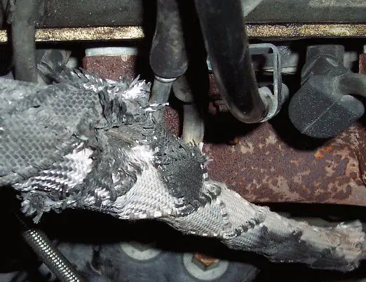

so guy and girls, any new ideas on how the water is getting into the dpfe sensor? only thing i can think of is that it might be sucking air or whatever through the connections or hoses. gonna replace it and try those ideas and post back any info will be b appricated thanks for any help :thumbsup:
Condensation
The water is from condensation. It's the main reason for the DPFE to malfunction. Many times just cleaning the hoses will restore DPFE functionality.
Do you still have the thermal sleeving on the EGR tube as shown below?
It reduces condensation. You may want to read the following thread for more information.
EGR System O&T
thanx for the tip,i dont think it is on there i'll be going out to look.
geesh
so there's like half of it on there.just enough to cover the back bend in the tube. the link you added was amazing. in depth as could be expected, i know why i like this forum, its people like you that make it easy for the people like me that need the help of seeing it.:thumbsup: your a respectable explorationist......:salute:
