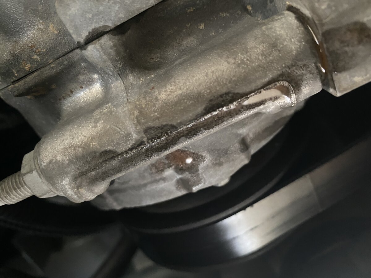

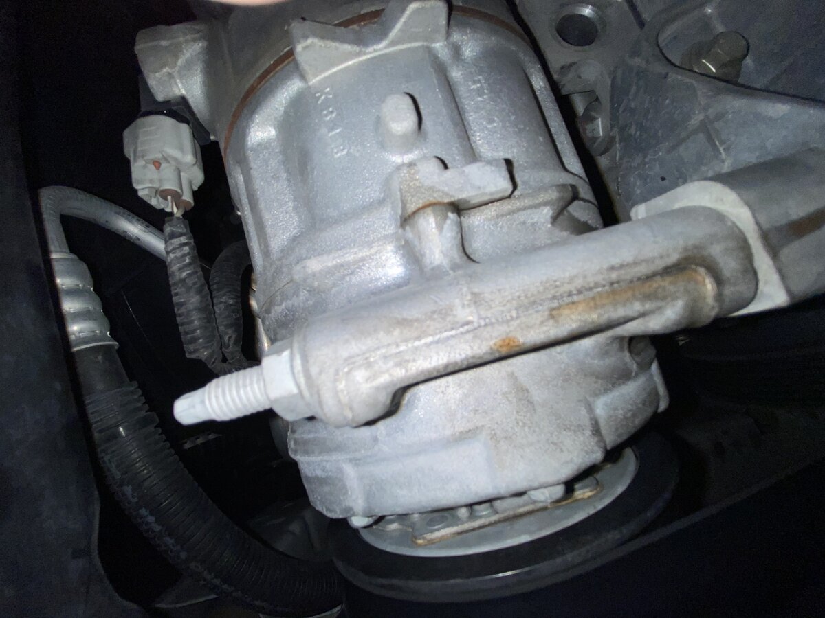

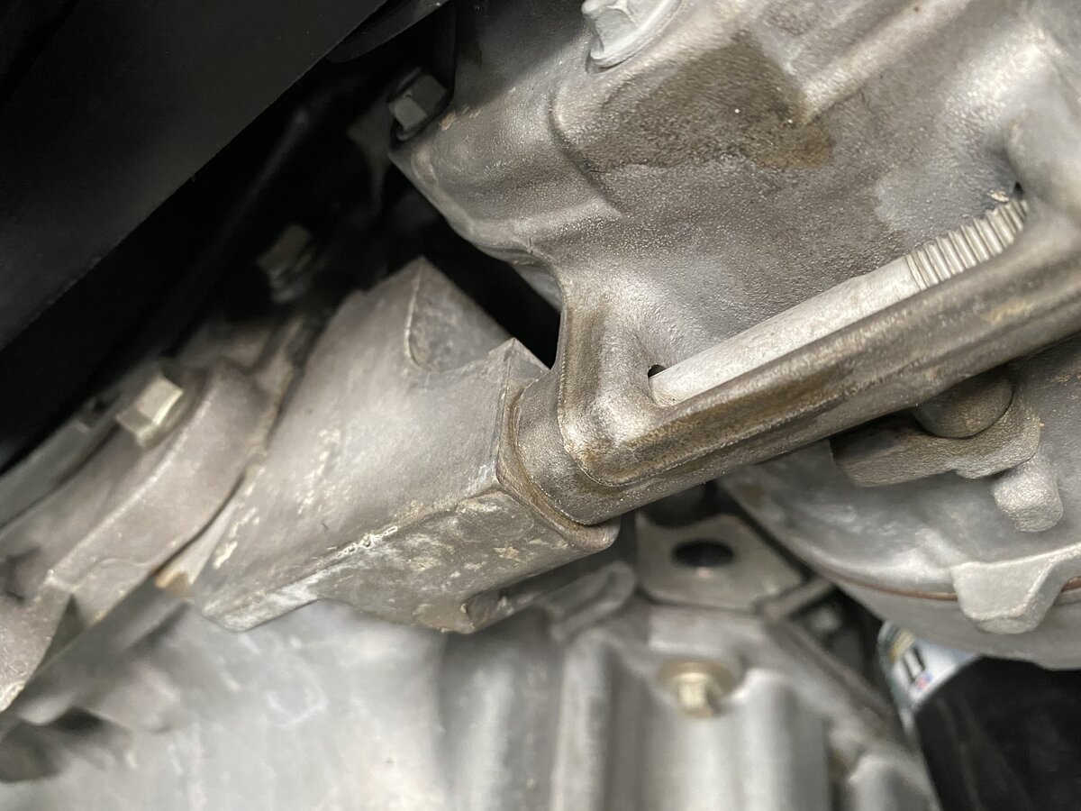

I back again for help. I took my 16 Ford Explorer to dealer for a red fluid leak around the ac compressor are as on the pictures they did a pressure test and found no leaks. Inspect engine found passenger side top engine mount leaking. How the leak was going there anyways replaced the engine mount and the leak continue i never saw droplets just sticky residue ok so another day coming from a 15 min trip i saw the second pic with the drops called the dealer and told me to take it. pressure test again and passed he said truck hold 16 psi and found nothing guy gets mad at me saying my truck is very clean under the hood and that all fluids are where they need to be. i show him the pics and he don't know where its coming from. I check all fluids and all are where there need to be the only one changing is coolant reservoir but is fluctuating on me. ok leak is still coming slowly with no drops just leaky red substance. should i take it to different dealer or could be possible while driving is slowly leaking or is trap inside and slowly droping or is something totally different that the waterpump. But if i take it to a new dealer and passes again the pressure test ? Other than that truck still runs like new with 83000 miles no overheat and no noises

That sure looks like a weep hole leak to me. It is located right under the alternator and will drip onto the compressor and oil pan area. Definitely stop driving if you can. I can almost guarantee your water pump is about to leak into the oil pan. All the signs add up... Coolant reservoir level drops and coolant dripping down block. Definitely internal waterpump gasket failure.

thank you for your reply i'll be booking another appointment to another dealer to see what they said the thing the truck may pass the pressure tests so they may think am crazy. Another thing to point is the coolant level on hot is at max line when the fluctuation happens its at cold some times close to the middle and some times lower.

Just about any fluid that leaks from a vehicle will have an oily texture except for coolant and windshield washer fluid. Get some of the leaking fluid on your fingers and see if it feels oil based or water based. Maybe get some on a paper towel and see if it evaporates or remains on the paper like oil would. Engine oil, power steering fluid and transmission fluid should feel much different from coolant. Also, coolant has a unique smell to it as does engine oil and transmission fluid.
Sure looks like coolant to my eyes. Looks no different than when my water pump recently went out on me on my 2014 Equinox with 152k miles.
coolant is the only fluid that is getting low very slowly sometimes is dry under the hood others liquid appears but dealer says its clean and pressure test passed two times in a month

I would do what I said earlier and get some of this fluid on your fingers and see if it is oil based or water based. If it is water based, is dripping from under the car AND your coolant level is dropping the pump needs to be replaced. No pressure test etc. means anything. It might only leak when the car is running at operating temperatures and not show up with a pressurte test. I would make them put the car on a lift, show them the where the fluid is leaking and have them tell you where the leak is coming from and what fluid is leaking. If they refuse to fix the leak then have them specify what they found on the exit ticket. Then find another dealer to look at the car. Our Edge had a transmission issue and one dealer refused to diagnose and fix it. The second dealer diagnosed and fixed the problem on the first visit. They did almost $4k worth of work under warranty.
ok leak is worse i was able to see the drop coming out of the weep hole now my question is can i drive it to the dealer like this ? is 5 Miles away 15 min/
if its leaking from the weep hole its probably not leaking into the oil. check the oil, top off the coolant and Id go for it,
