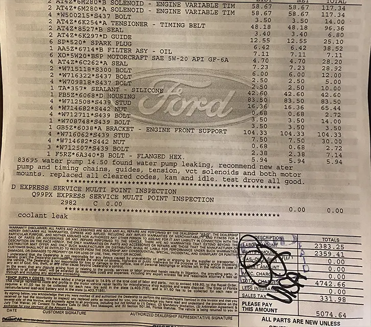

After looking around for shops most other shops were asking from 2500 to 3000 just for water pump i really always take my truck for service to ford for the same reason i paid before almost the same for brakes on other shop/ any ways here are the receipts any opinions would help also am going to talk to Ford warranty even if maybe am wasting my time. Money i don't have. have to look for a loan just want to vent some where i guess hopefully it helps some one else in the future. Also my serpentine belt makes a low buzzing noise, am just tire to go back to the dealer been there 4 times in a month. In addition my first explorer was a 2004 and this is a 2016 many people said those are the worst years :D my 2004 Explorer stay with me until 200000 + miles until i sold it to my neighbor for 600

Ouch!
Could have bought a 2004 explorer for 5 grand
I knew the labor charge would be intense but over 2 grand? Its a 10 hour job or somewhere in that area so $230/hour is ridiculous. I should get in the water pump business
Ford is close to pushing attorney rates for car repairs.

I doubt you will get anywhere with Ford in helping to pay for some of this. Every buyer has the option to purchase an ESP which would have covered this and likely would have cost you about 25% of what this bill shows. It could have been worse if it took out the engine too.
