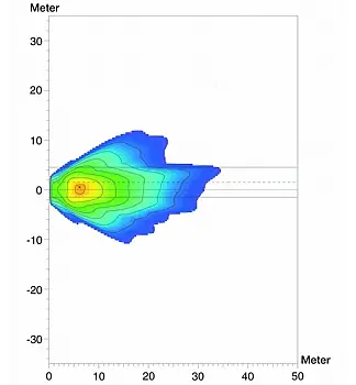

... the stuff further out is reflected back to you on a straighter line, which is going to add to glare. That is why they don't design fogs to put light far out.
I appreciate Hella for publishing their beam patterns. You can see how the intensity of their fog version of the Micro DE dies off at about 25 meters, and the driving version dies off at about 170 meters. Also the differences in beam width.

Hella Micro DE Fog

As a side note of interest the Hella Micro DE Fog light is actually a Halogen H3 bulb stock, and the Driving light is a HID Xenon bulb.
HIDs in properly designed emitters, 4300k = the most usable light, properly designed fogs mounted low for the rare occasion you use them. Sums up everything we need to know right?
Yes that is about it.
