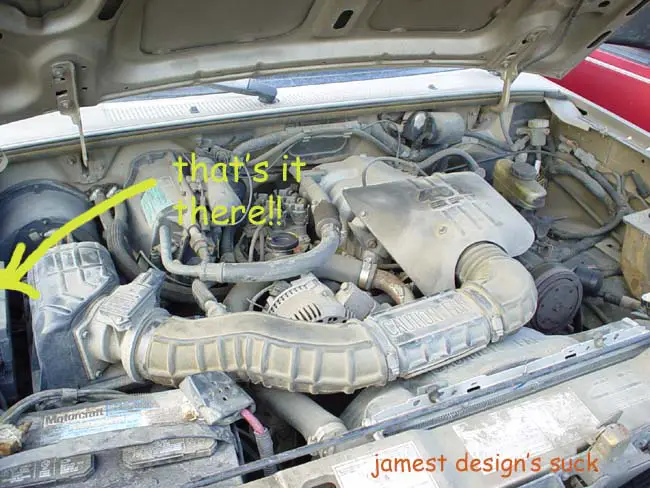

Check UNDER the power distribution box under the hood for the relay.
Welcome to the site, good to see another person from Maryland here, the relay if I remember right are in a black holder about 4-5" long on the pass side of the engine bay, just sort of hanging from the electrical harness (I could be wrong, cause only the 91 and 92 had the relays mounted this way, 93+ they are in the power dist block)
Yes they are correct, to be more specific, they are located under the hood on the passenger side, under the power distubution box (fuse box), they are a bit difficult to get at but not really that bad, it is very common for them to get wet and rust/corrode and stop working, as this was the case for my Navajo.

That is funny Jeff..using a pic you took of a for sale X for reference....:D

Trying to be resourceful. ;)
