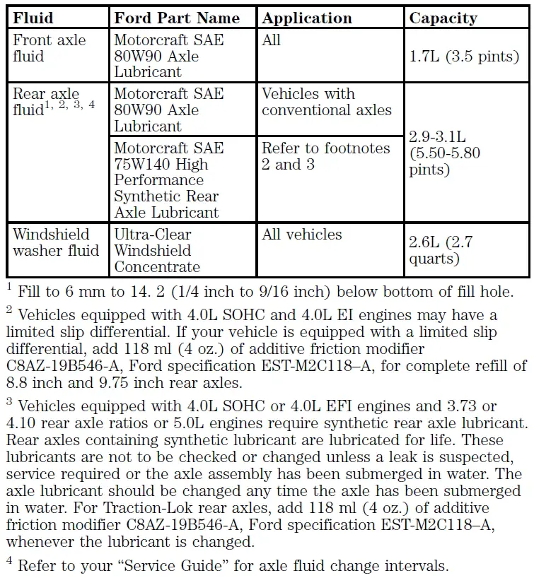

I have a small leak in the rear differential. So I thought I would just top it off until the weather allows more time to change the gasket. I looked in the manual and became completely confused. So I looked around here and obviously didn't know what to search for, so I'm still confused about what to put in it. And I would like to get this right before I dump everything to change the gasket.
This is the page from the User Guide under service, fluids or whatever.
So if you read that, you can understand my confusion, or do I just not get it?
