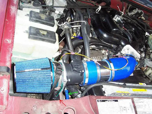

I have been very happy with my K&N intake.

kn with an amsoil filter, ive also heard many good things about volant. you wil get ideal performance by running the stock airbox with an amsoil filter or other hi-po filter.
Agreed, I have heard good things about Volant too. They didnt have anything out for my 4.0 OHV at the time. There was not anything much out when I bought the K&N FIPK kit. I dont remember any other choices aside from something by KKM? I believe which was a green colored intake system.
