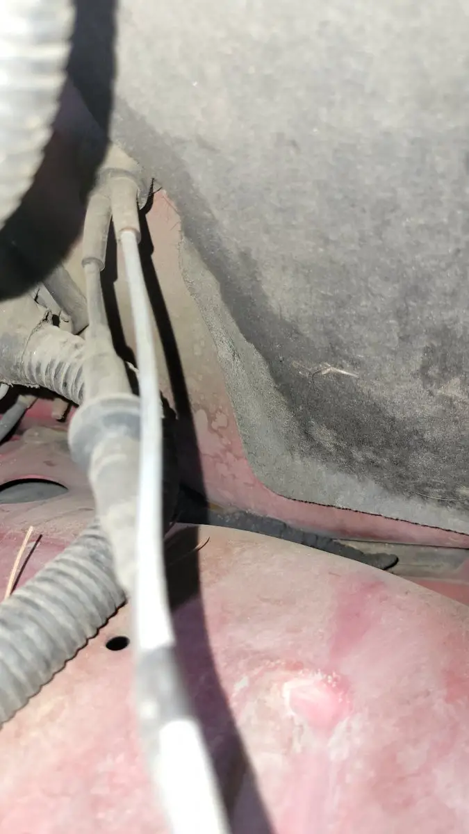

I noticed this line was disconnected and I have no idea where it goes or what it connects too. Any help would be greatly appreciated.

More pics. I can't find anywhere this hose attaches too. It seems to be tapped to another vacuum line so it must connect somewhere in that general vicinity.
I can't make out much from the pictures, am more of a hands-on follow the hose type person...
You have the two vac lines going through (coming out) the firewall. One of them should go to the water valve on the hose to the heater core, so I would try to follow the hose connected to that heater core valve and look for a Tee on it.
The other hose coming out the firewall should go to a check valve connected by another piece of hose, to the vac reservoir ball, or direct to the vac reservoir ball if the check valve is built in or on the vac reservoir ball.
The other way to try to figure this out is by symptoms. If it's going to the heater valve, you lose control of switching between hot and cold, would have lack of vac on the hose to the heater valve for both hot and cold, dash settings, while normally one or the other dash setting (hot vs cold) would cause vac on the heater core valve.

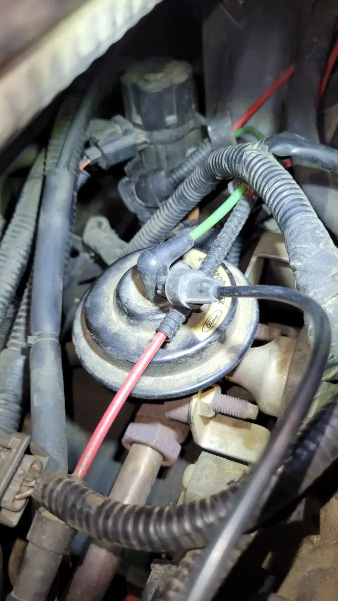

Is this the vacuum reservoir ball you were referring too?
^ No, AFAICT that's the EGR valve. The vac reservoir on my '98 is mounted on the right front wheel well liner and looks a bit like this:
