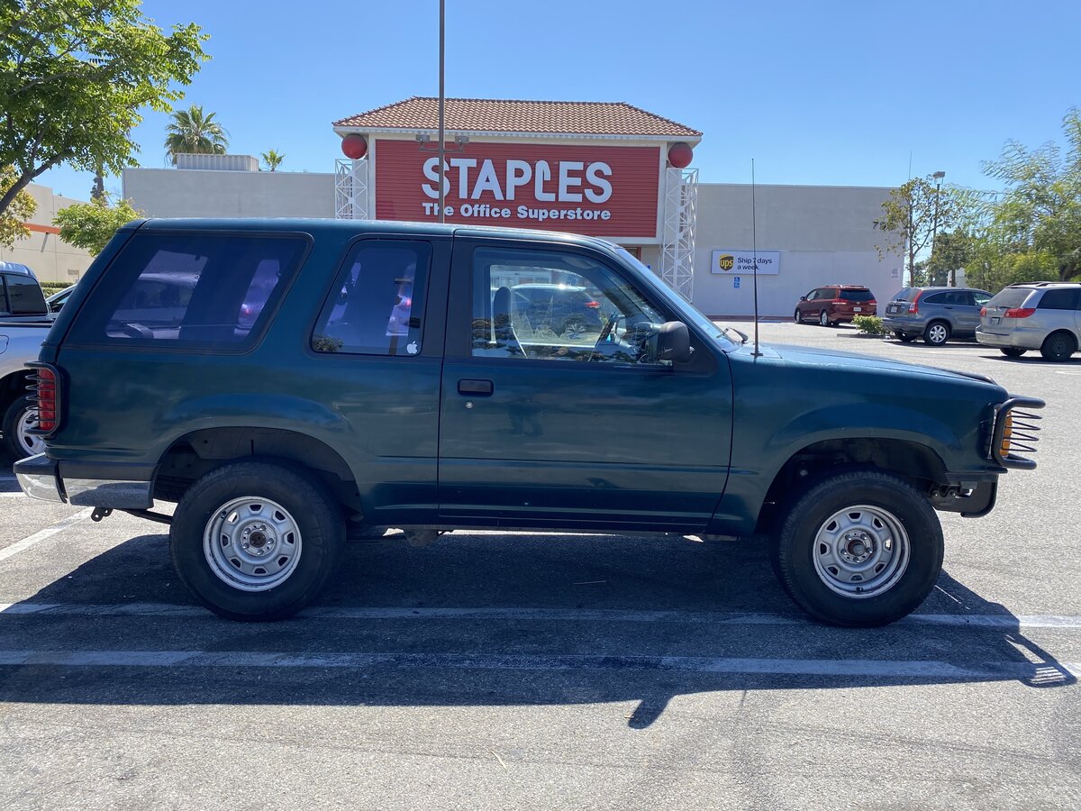

I am looking for some tires & rims for the green bee I need some ideas. The 33x12.5r15 was a choice I want to go with but the offset of the rims is what I have no clue about. I have about 2” inch lift but it’s a 2 wheel drive with 3.27 gears in the rear. I don’t like body lift. Here’s the the rig. I think I could fit 33,s
I doubt you can fit 33s. And with 3.27s it’d be absolutely miserable. If it’s an auto you’d be shopping for a transmission soon enough.
It still won’t have the gear to pull 33s reasonably. Standards have considerably less torque.
Yea I figured. The only way it’s to go bigger gears with the disk conversion. 31s might be the only way to go or 30. I don’t like how my truck looks rn
Yeah easiest is to slap a later model complete axle in. The OHV ones would likely be the least worn. You can find open 4.10s and then add a lunchbox locker fairly cheap.

Get 3.73s at least. 4.10s would be much better though, as others have already mentioned. Buying 33s for looks on a 2wd isn't my cup of tea, but if that's what you are set on...gear it first. 31s on a 2-2.5" lift looks pretty sharp and is far less expensive investment both short term and long term. Unless it's an all out prerunner rig, I urge you to be honest with yourself about what you'll be using the vehicle for, and how much you're willing to spend, and put up with.
