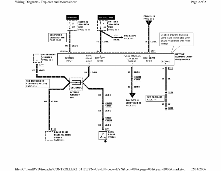

Interesting. I have come across other sites (other manufacturers discussion boards) where some people have issues with DRL and HID kits. Flickering would suck! I just scoured my Ford DVD and confirmed that the DRL module does reduce voltage to the low beam. If it reduced the high beam I was thinking of one of those dual bulb models (Xenon low, halogen high), but that's moot now.
What's involved with getting the DRL module to light up perhaps the fogs or maybe the corners? That way HID low would only be illuminated when the low beams were on (i.e. DRL would never activate the HIDs at all).
Wiring diagram ('00, I assume it's the same for '99)

I checked my '99 CD and it's a bit different but if you cut the Red/Black wire coming out of the DRL module and hook it up to the fog light or corner light positive wire you should be set. Make sure you use a diode when you hook it up though otherwise it may cook your DRL module
Gary, I may have to try that. What about disabling DRL module altogether? I know they're for safety and all and I'd probably get a ticket if a cop really wanted to be a dick, but what's involved do you think? I've heard of people who disable modules only to have their low beams not work at all.
If I were to go the HID route (and it seems to be that way...tax refund coming and all), then I'd probably just hook it up as is and see what happens and go from there.
Try just unpluging your DRL module and throwing some tape over the connector or you can probably cut the Red/Black wire and tape both ends and see if that works. I don't see why unpluging it wouldn't work though.
