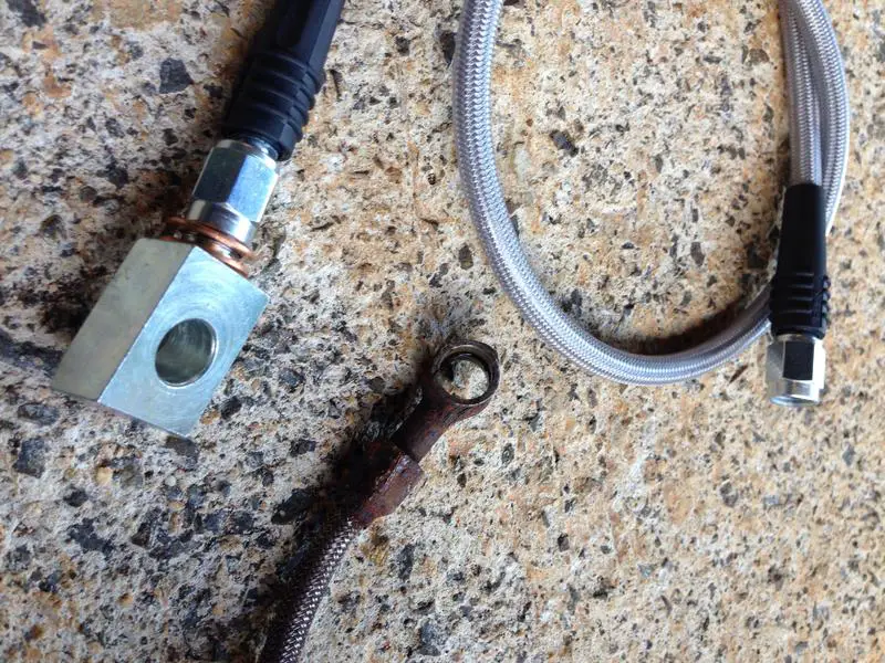

Here's a pic of the new ends next to the old. I went with the block instead of the round banjo that I had, as that thin round wall is where the leak happened.
Question is, these came with two copper washers per hose, do I put one one each side of the block, when bolting it to the caliper? Seems like the washer on the inside would keep it from fitting flush...

Yes, washer on each side is the seal. Don't over-tighten or you will crush the washers and get another leak. What I did / do with the banjo type double copper washer fittings is; Tighten until you can feel it start to compress the washers. Bleed brakes. If it leaks, tighten slightly. Repeat until it seals. I do this because I have a habit of over-tightening everything.
Nice lines. It looks like the line is removable so you can just replace the block or the line if they go bad.
Thank Brian. Yeah, they gave me the option to have removable ends.
