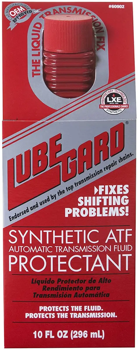

I also use this stuff
I installed a motorcraft gasket and filter
I also installed a https://magnefinefilters.com/NEW-Ma...ine-Power-Steering-Filter-R038M-P-3810000.htm
I Change every two years
