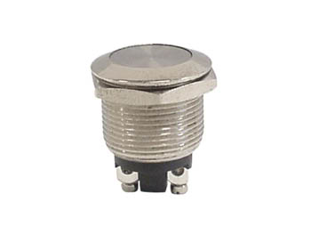

I am mounting a set of black anti-vandal switches flush on the inside of my center console storage tray. :exp:

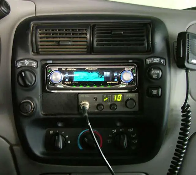

This a older picture, but mine are in that black spce there next to the CB
Here is mine.
BTW I'm totally doing that with my CB as soon as I get an aftermarket head unit. Thats real sweet. :thumbsup:

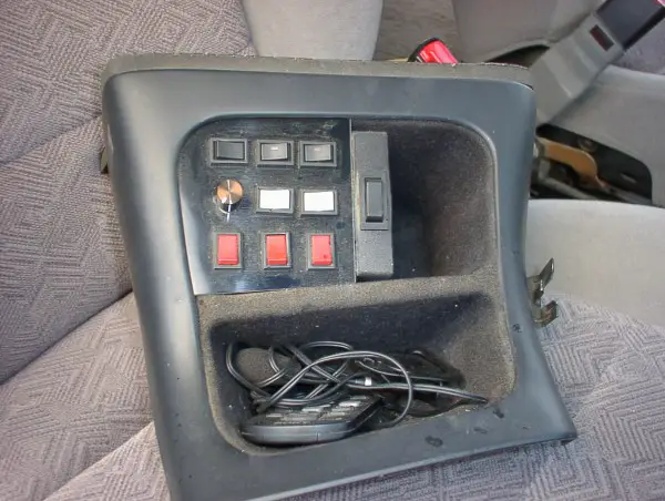

here is were i have one of mine(an older pic of my interior) and then i have two more for my roof lights over by the head light switch.....they are just the rocker switches though.
There are two in this location now...

Mine are in the center console and I have something else hidden inside the center console.. I'll give you a clue, it has yelp, wail, hi-lo, etc.. :D Just have to finish the install by putting a speaker in the truck.
you stole my idea ben, but mine is an old car alarm siren.
For these:
