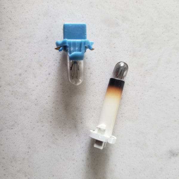

I'm not having any luck finding these bulbs. Dealer said they might have the long white one but no part number on the blue one. These are from an 06 Explorer. The blue one (takes 2) lights the AC/Heater controls in the center dash below the radio (manual controls). The white one lights the headlight switch. Any suggestions on where I can find these?
The blue one i believe can be removed from the holder and a number 74 bulb will fit in its tight though. The long one you will have to find. Here is where I got mine you will need to contact them for a quote my minimum order was 10
jkllamps.com
p/n DNW1-EW33/30MM
Lot# 15B2601K
Edit it may not be a number 74 bulb. Take the bulb with you to the autoparts store and match them up after you remove it from the holder.
Thanks, didn't realize the bulb comes out of the blue socket. I'll see what I can find.
Yep it was a 74. The other bulb only comes with the switch assembly. $41 to fix a bulb is more than I want to spend on this car. I always leave the switch in the auto position anyway. Thanks for the help.
