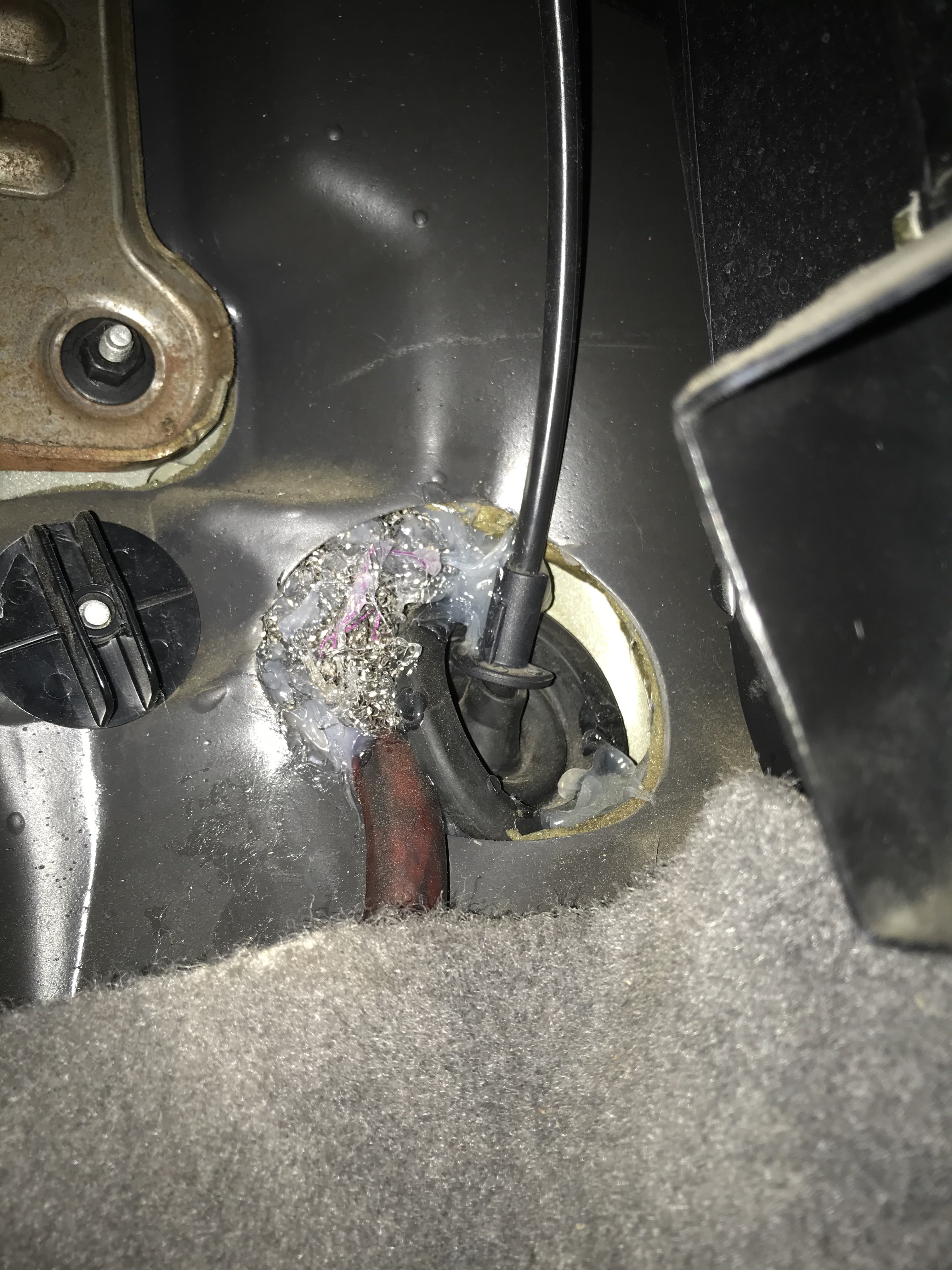

Mine for my subwoofer and light bar and future fog lights

Before doing this, just slit a hole in that grommet and don’t just jam it out of the way and gob silicone on it.
What does that one thing lead to I don’t want to poke a hole if it needs vacuum or something

That’s just a grommet through the firewall. Just slit next to the cable, and everything will be fine. On one truck I used a core drill, the other inslit with a razor.
If you look to the left of the pedals, I believe there is a second grommet.
There's also one to the right of the pedal box, about 2 inches below the edge of the carpet.
