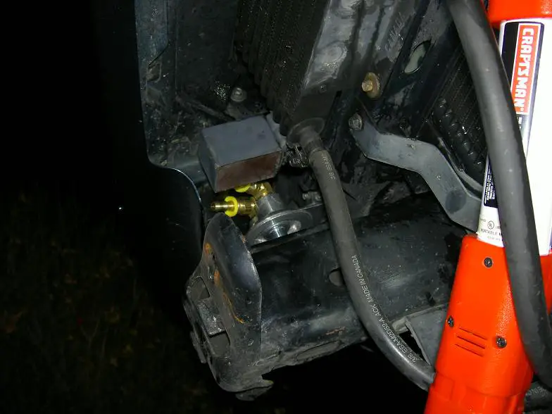

My 99 truck is likely to be obsolete for me in a week or so, the USPS has assigned me a POS big white box for my route. Here is my trans filter though, can you tell how well I hid it? It's right in front of the body mount behind the bumper. Regards,

CW: I was thinking of the filter before my rad, where I was going to put in the temp sensor.

Ken, most filter adapters have a 1/8" NPT port on them, perfect for a temperature sensor. I just took the bumper off to do mine.
