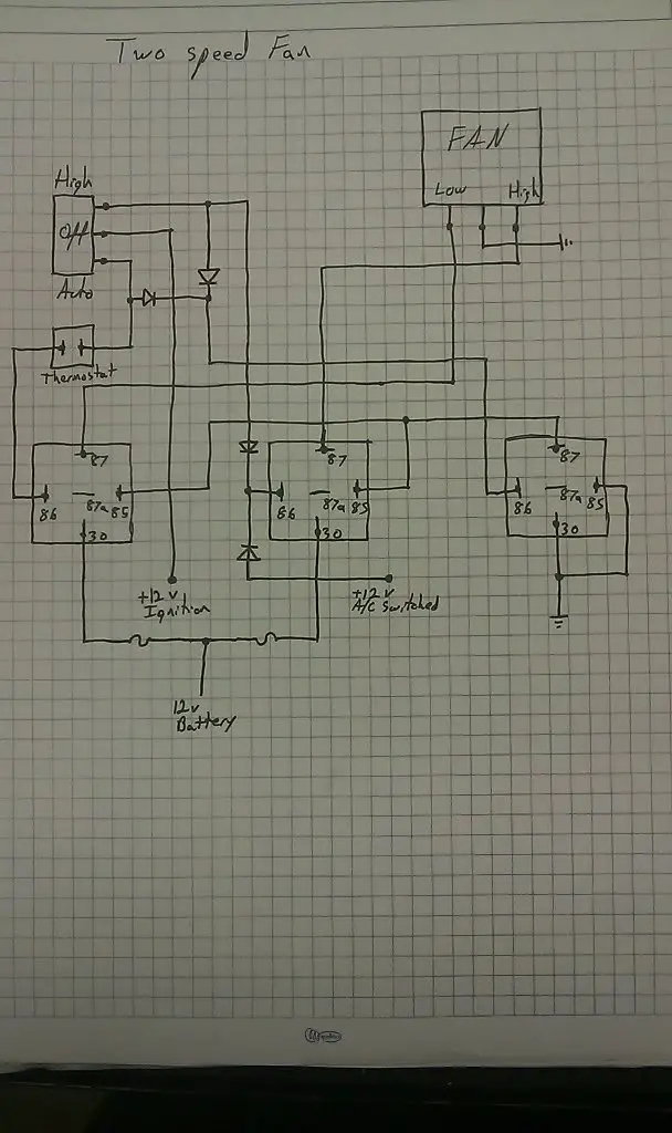

find a dual speed fan from a Grand Cherokee Limited. Hook the high speed up to your a/c and the low to the thermo-switch. Bear in mind though, you will have to mount the fan to the shroud. Better yet, grab the Grand Cherokee's shroud and make it fit. They are similar size. On high they crank out way more air than the stock one. you can't mount it directly to the radiator because the blades stick out from the frame about 1/8". On the J**p they mount with 3 screws into the fan shroud. run two relays. Advanced Auto parts sells a fan relay w/thermo-switch kit for like $20. that covers the low speed.
BTW, I tried the Taurus fan and it didn't fit well, and it didn't have high enough CFM to cool when the a/c was on.
I planned on replacing the Taurus fan with the Cherokee fan but I had already tossed my shroud. But I was going to use this wiring setup.

Thanks for the great schematic Tweak!

Elaborate, I just use it as a control, it does not power the fan and I have not had a problem yet...

i know its been a while since anyones posted anything but i have a question or 2 for you. 86 is the input and 85 and 87 (85 when open 87 when closed)are outputs 30 is power. if im right (which i think i am but not 100% sure) then it runs like this, switch is set to auto which allows the circut to engage t-stat which when closed due to temp engages 86 on first relay which engages fan. the relay used for high speed is only engages when switch is set to high which engages high speed on fan the 3rd is the grounding relay. ok now that i wrote that i think i figured out what i was going to ask but i'll ask anyway. if i install a 2nd tstat but a higher temp in series with the first, could i set that to a relay that would disengage the low fan relay and engage the high fan and set both to the auto switch. please correct me if im wrong. 2nd question is how many amps are being pulled with the low and high speeds so i know what relays and fuses to use.
