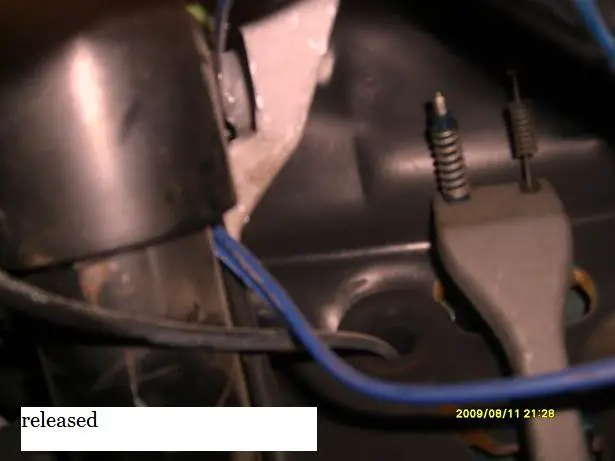

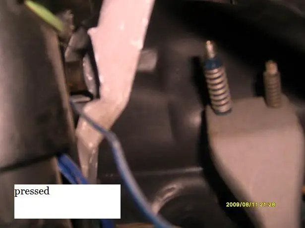

i wanna see if i can do the mod feels like my accelerator not working right. i have to punch it for it to work right or press hard feels like theres something behind the accelerator heres pics thanks

As for which one is the throttle... I'd say the one that it poking way out past the spring. I'd say the blue one is the kickdown. Follow the mod steps and you should be very happy. A number of zip ties clamped down on the cable and cut off also works well from what I've heard.
The one sticking out is the kickdown. The blue one is your throttle. So from what you are saying the accelerator is binding/sticking? In that case either the cable is corroding or the butterfly in the throttle body is binding for some reason.
I thought the kick down had a self adjuster and wouldn't leave slack in the cable like that??? I have a manual and my throttle spring doens't look like the blue one but the "loose" one in the pic..... wonder why manuals trannies would be different?

Its the blue one, all you gotta do is turn it on and yank each one to figure it out, I just ziptied the wrong %&^@ cable... Now I gotta redo it
The reason the kickdown has slack like that is because it's not supposed to be pulled unless you are at full throttle. Slack at normal and closed throttle is how it is supposed to be. The kickdown is only for full throttle use, not for normal use.

I just went out an checked, on my 5 speed (no kickdown cable) the spring on my ONLY cable looks like the kickdown cable in those pics, not like the blue one. Wonder why, are manuals different? Or is it an aftermarked cable? I have 0 play in my cable, I looked to do this mod awhile back but didn't need it bacasue mine was fine. 93 with 165k.....

The one closest to the steering column is the accelerator cable. I did the mod 15 minutes ago. Two baby tie wraps to take up about .25" of cable Brought me to the throttle body butterfly being full open when the Pedal is floored. Big difference now that the butterfly can open up full.
