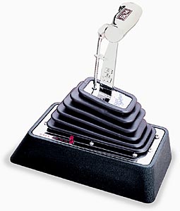

i was lookin at the b+m starshift... it looks pretty cool, the only thing i dont know about is shifting down.... stupid question but can you just slam it down like you do slamming it up
B&M StarShifter
Product images may differ from actual product appearance.
Vertical Gate Action
Features true vertical gate action. In the normal mode it's a straight line detent shifter, with a trigger activated reverse lock-out. Once the lever is in low, lift the trigger all the way and pull the stick back to convert to ratchet shifting. Now bang the stick forward as hard as you want for the 1-2 and 2-3 shifts. You can't miss a gear! Includes a standard neutral safety switch. Cable operated and works with GM TH400, 350, 250, 200 / Ford C-4, C-6 / Chrysler 66-up Torqueflite 727, 904 / AMC 66-up Torque Command.
130-80675 StarShifter | View Product $149.99
I dunno about the starshifter, but I know that on the megashifter you can..... it rachets down OR up..... and you can get the megashifter in a truck version (comes with a taller base)
