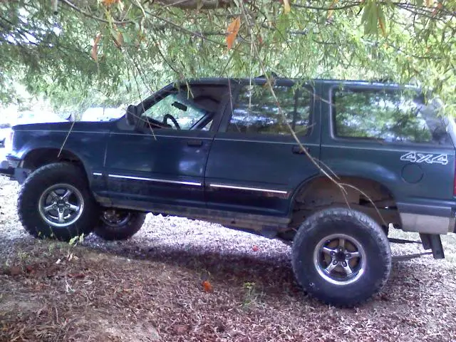

...you cant fit 33x12.50x15's with only 2inches of lift?

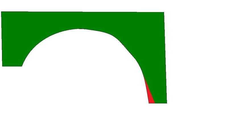

I used a 2 inch F150 leveling spacer in the front, made my own shackles for the rear, and only had to trim a 1.5" by 4" triangular piece of fender off the front. Had to trim the crap outta the fender liner, but it still does its job. I ran it through a ditch at my buddies house, the rear tire stuffed up into the fender and hit the body on the inside, no fender lip contact or sheet metal damage from flexing out as far as it would go. Wish i had pics of it, its back stock now.
