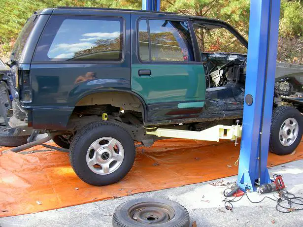

In case you didn't think the body was really off of the frame;
impressive...
im also super stoked that your hoist is OUTSIDE!... nice!
you got some flood lights out there too?
Just those on the end of the garage, and it's my friend's house. I spent a lot of time working with my friend on stuff, so it was a good deal for both of us. It's my lift and it was affordable as part of my 99 Explorer rebuild project. It cost less to fix that one and buy the lift, than to sell my 93 and buy a 98-01 Explorer Limited, in 2005.
