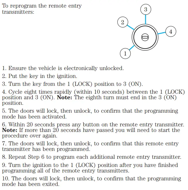

My 05 Explorer will not go into program mode to program the fobs.
Any ideas? I'm at my wits end and don't feel safe about leaving it with no alarm.
Thank you.
Is this what you are doing?
Note this should be done with the driver door OPEN and electronically unlocked means unlock all the doors with the electonic push button on the door.
Yes but the owners manual never said to do it with the door open I have done it with the door closed Thanks I'll try it with the door open.
Thanks for the procedure. My old fobs are almost worn off, I bought new ones but lost the programming procedures.
Appreciate it.
