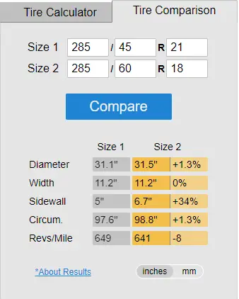

Your thread has been merged with this one. It seems that the 18" PIU wheels will fit the ST with the 21" wheels.
A 265/60R18 tire or a 245/65R18 will be a -1% diameter variance.
