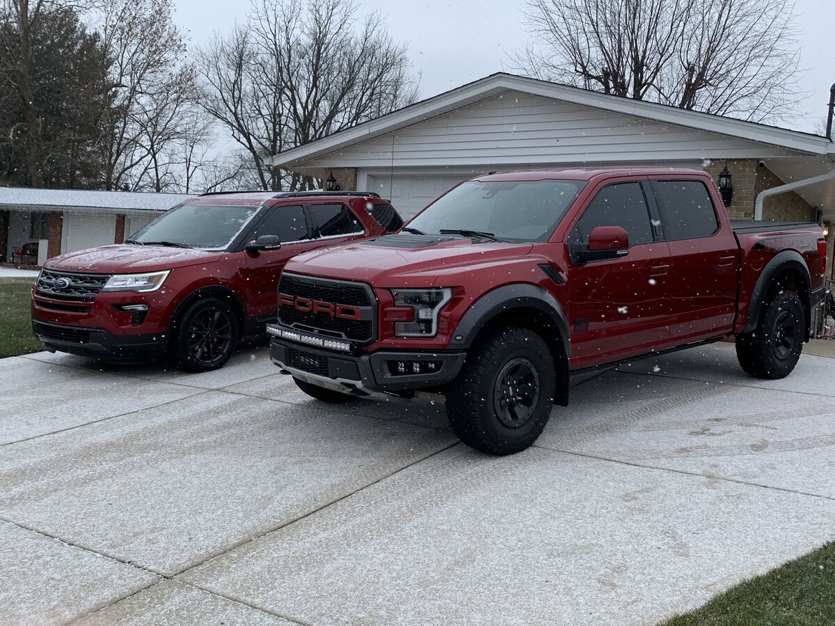

I bet you would like some actual Winter tires for your driveway, in that snow and hills.
I bet that I'd prefer to just keep doing what I'm doing which is not buy, store, and swap winter wheels twice a year. :)
I have no interest in doing that, have never gotten stuck, and the only accident I ever had was one where the sudden ice storm, caught me by surprise and replacing a single tire ~25 years ago, is a lot less expensive than a lifetime of burden continually buying and swapping on snow tires. It just doesn't get THAT cold here, but the colder it gets in someone else's region, the more they make sense.
People forget how differentials work, a 4WD with two open diffs, is just a one front and one rear drive vehicle. Having an open front means you have three wheels pulling at most(with an LS rear).
Unless it’s a Raptor, which locks all the wheels, making it an actual 4wd.
